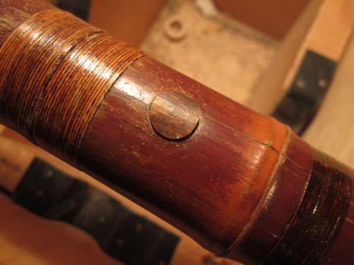

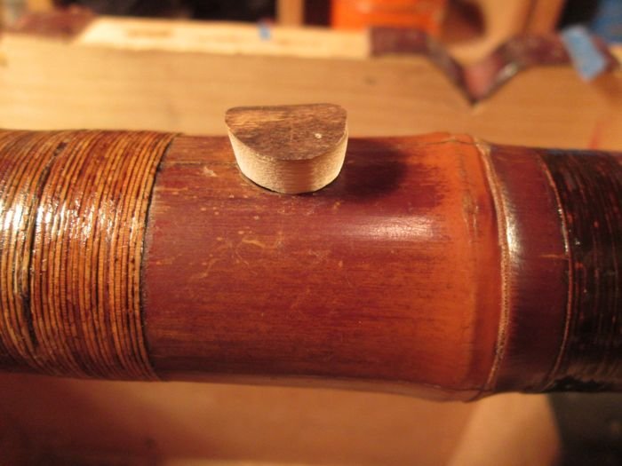

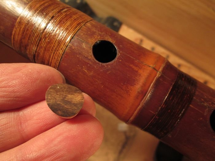

I think the best way is to make a plug from bamboo or wood. Plaster will not hold up over time.
Just cut a small square that matches color (or not) and use a disc grinder and flat rasp file to fit.
I use 2-ton five minute epoxy to glue in. There are photos of finished plugs here: https://www.facebook.com/shakuhachi/media_set?set=a.1092314102023.2016320.1…

How can i cork bad holes and drill another ? what kind of mix do i have to do with bamboo powder?
