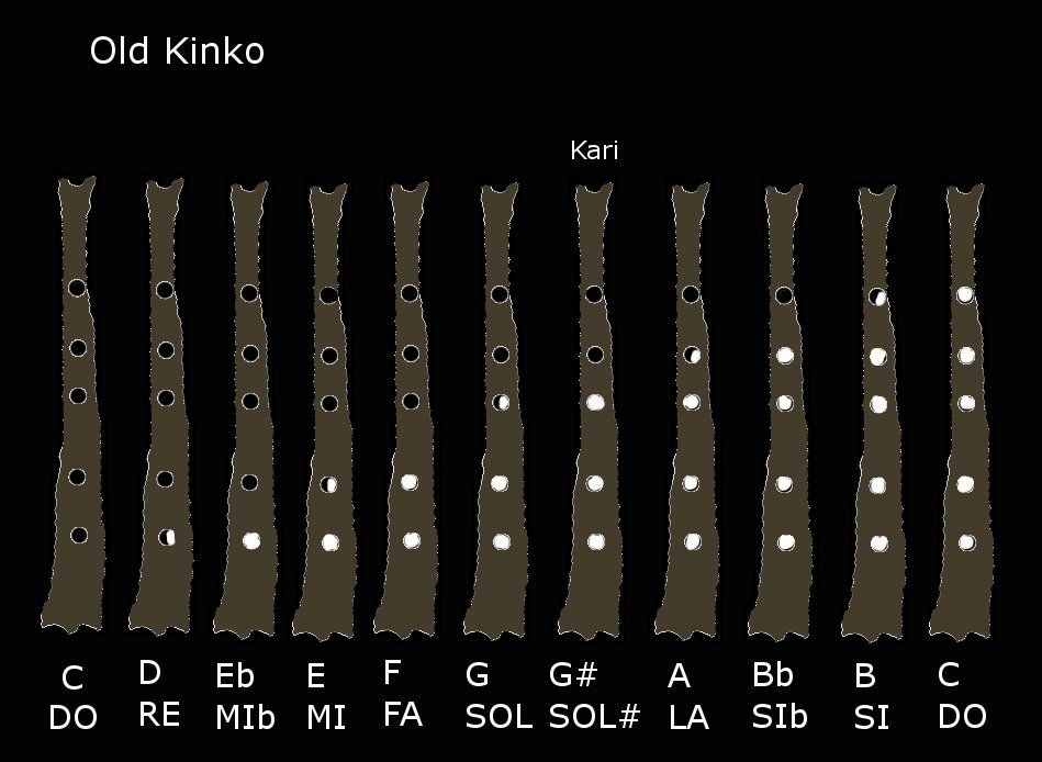

Hello to all,
I made the drawing of the notes which I find with my Shakuhachi old kinko.
I would like that somebody says to me if these notes are normal for a Shakuhachi 2.0.
or if this Shakuhachi is different maybe because it is old and because it is not tuned in the same way as one 2.0 more recent.
I thank you for your answer.

Bonjour Plume Blanche,
Your fingering chart would be correct on many old flutes (all things being equal). The #3 Chi hole is often sharp compared with the full step Western relationship between Fa Sol. Your SOL# fingering is normally the Perfect Fifth (SOL) on contemporary shakuhachi.
Hope this helps, Perry
