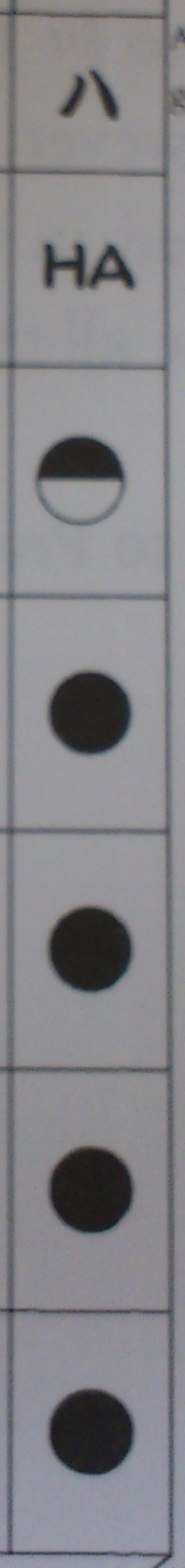

In “Blowing zen” ha is done like this:

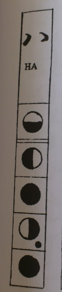

In “The Shakuhachi, a Manual for Learning” it looks like this:

There are a number ways to play ha, including those indicated. Some variations between styles of course.
In Kurokami, the ha that precedes kan no ro is most easily played by closing 1 and 3, partially shading 4, and playing slightly meri (1 being the bottom hole). The ha in the second image is D on a 1.8, top of the kan register. As indicated, crack the 5th hole open a little, and meri a bit. Rearticulate using the 2nd hole.
