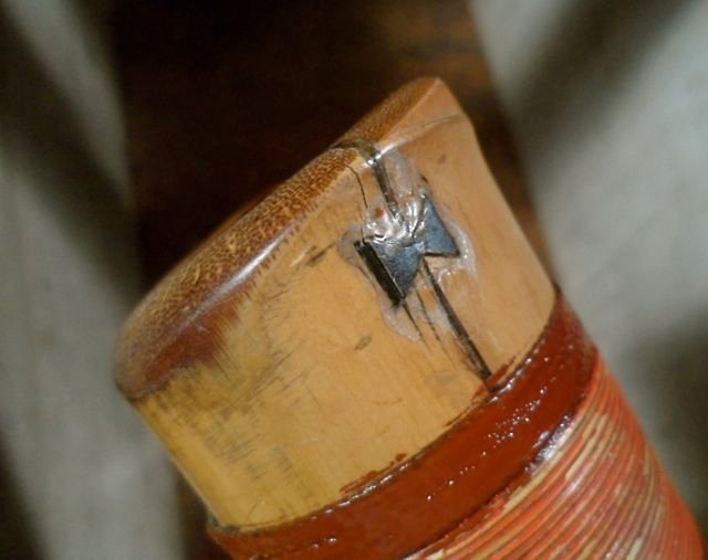

Hello,
Wanted to ask to those who already has used nails, 2 pins ones with a U shape, to keep a crack shut (after having the crack closed in a wet box). I have seen pictures a few old bamboos repaired this way, feels really neat and efficient, so I ordered a few from Japan, as I have a crack line on a 2.1 jiari between nagatsuke and 5th hole, where they like to appear! Being winter and lot of dry heat, it is getting worse, and as I was unsuccessful making strong enough bindings in the past, as the cracks always open again shortly after the bamboo gets dry again.
Anyone has some experience using them? I remember as an apprentice carpenter, I was told to slightly crush the end of a nail with a hammer, to prevent cracking the wood when entering into the fibers. Also, need to consider that the length of the nail (8mm, quite long) should be inferior than the thickness of the walls.
I read some time ago from Perry Yung that he don't advise using them because of some other micro cracks they create.
Any feedback from those intrepid flute makers who tried them anyways?
Bindings, I will consider that if nails are really not advised, and probably send it for that, but if I can avoid, that would keep the nice aesthetic of the bamboo, and give an Edo period touch with the silver color butterfly nails. If they were used then, why not now?
Thank you!

Bonjour Dominique, I don't use the butterfly nails or Kusabi nails. But sometimes on the bottom section of the bamboo, where it's very thick, I might embed "U" nails. which are then hidden under bindings.
The kind of binding is a personal thing. What's important is that they are done well.
Merci, Perry

Hello Perry, thank you! And glad to hear from you. Yeah, this makes sense, next to root should not harm. I might send this flute to you for bindings, and will message you private then.

Dominique, this is a very common result of kusabi nail repairs. Over time, they cause tiny cracks around the original one.
I often dig them out, fill and then bind over.
Looking forward to hearing from you.
Merci, Perry
