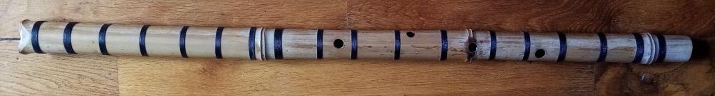

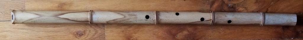

you have to try several option: yes choose nodes for utagushi but not necessary for botom and you can have good shak with holes near nodes...sorry Remy!
here are some exemple of natural dead piece i'ved made whitout roots end :
exemple 1 : 3.0 ground level in E
exemple 2 2.0 in C
exemple 3 2.72 in Fa# : for exemple this one has one hole on node: and it doesn't matter...! in these caes on these place....
more exemple on my blog: shakuhachi-bamboo-clarinette.com
