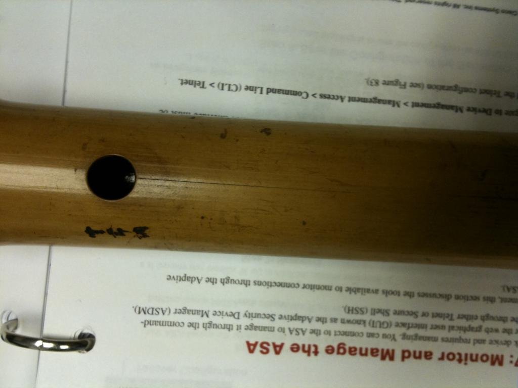

I must have jinxed myself by thinking about a crack. After getting Jeff's feedback I decided to leave my bamboo shakuhachi home over the weekend while I went camping to insure it was kept at a mostly stable temp, opting to take my used and abused Yuu with me instead. I came back to a happy healthy shakuhachi Sunday night. Sometime between Monday evening and Tuesday morning my shakuhachi developed a crack under the thumb hole
My first reaction was to have this crack bound, but another shakuhachi playing friend of mine suggested that I could keep playing it until the crack affected playing before having it bound. Any advice one way or another: bind now or wait?
Edit: to clarify it was recommended that I could monitor the crack for stability. If it worsens it was recommended that I send it in for repairs, if it's stable hold off. This makes sense to me. Any other opinions?
From everything I've read, a small crack is guaranteed to become worse over time and must be attended to immediately.
I imagine it to be like a crack in concrete. As the seasons pass, it's guaranteed to get worse from water getting in and freezing.
Perhaps the bamboo could be affected by temperature and humidity much more aggressively in this cracking area? I'm unsure.
I have done two things to address this. First, I bound the flute below the thumb hole with upholstery thread and no glue (so I can remove the binding and send it in to a pro if it ever gets worse). Also, I put a little black dot on the end of the crack using a fine point sharpie so I can monitor if the crack moves a mm (or less).
