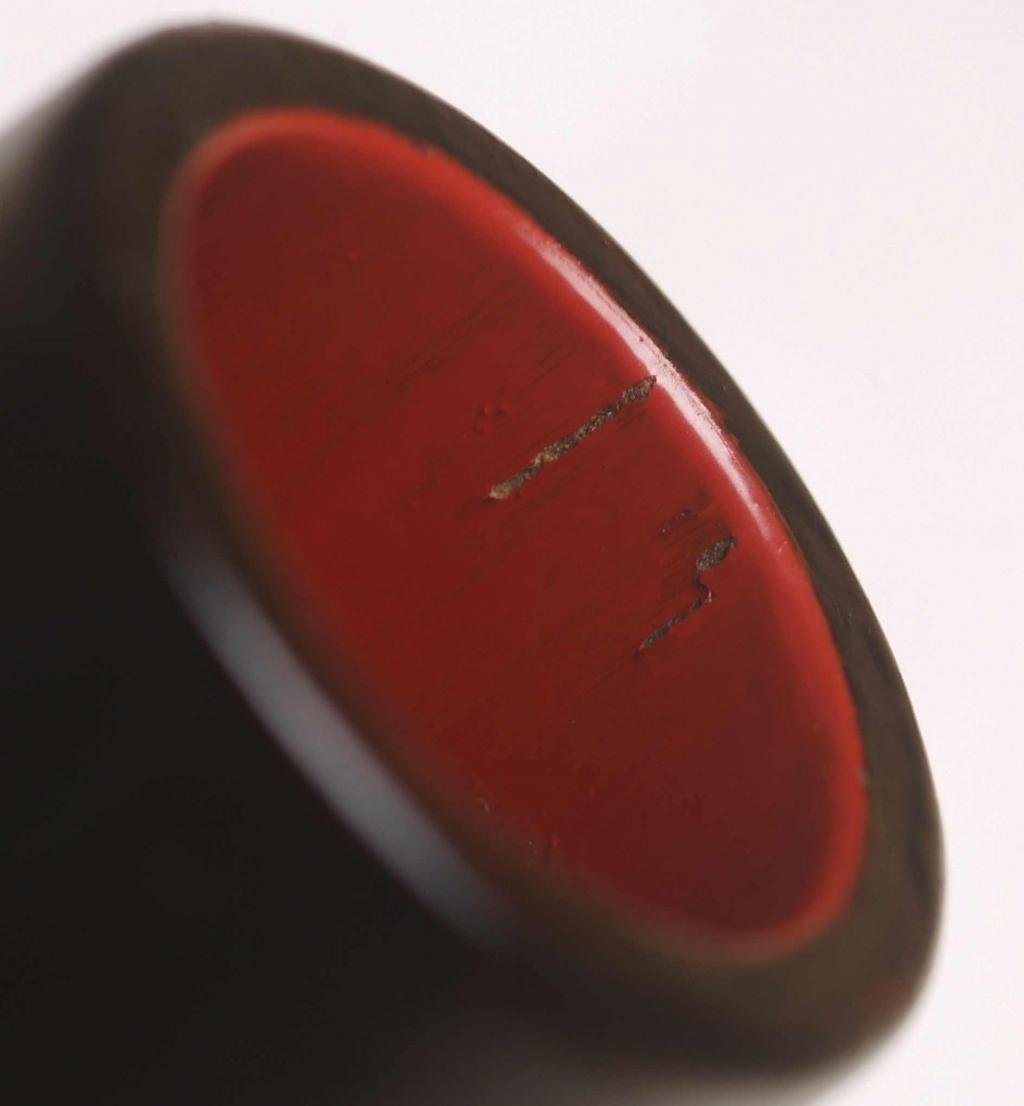

Dear all
I come to you for an advise
I have a two piece flute which is very hard to separate. Yesterday after a long "separation operation" i heard a suspect "squeak" noise so I inspected the flute
The bamboo seems ok but I discovered a thin fissure in the urushi localized at the bamboo insert. It goes from the external borderline of the insert following the bore on a half centimeter.
Do you think something has to be done?
I suspect that the bamboo insert is a bit too large, that it becomes compressed when the flute is assembled, and when I separate it it suddenly uncompresses and this caused the urushi fissure
thanks for your help

Hey LowBlow, My partner calls me the shak doc. Like any doc, I can't offer any good advice unless i see the patient (i wouldn't use any glue). Christophe, can up post a photo of the fissure?

here is a photo. Yesterday I discussed with several people who had the same problem (I saw such fissures on their flutes).
I have been told that it is simply caused by a wrong movement when disassembling (Roughly the force induced by striking with my fist on the top of my hand
would not be sufficiently parallel to the flute). What do you think?
have a nice day

Bonjour Christophe,
I see there is Ji plaster under the urushi. It should be sealed to prevent breath moisture from causing deterioration. I recommend a traditional repair with urushi but if this is not an option, you can try a low-impact fix by painting a thin line of fingernail polish just over the fissures to seal them. I would use clear lacquer as it is thinner than pigmented lacquer. I would avoid using glue as I have had to do more work removing it when refurbishing this type of damage.
I see a tiny flap on the bottom fissure. You may have to gently remove it so that your cleaning cloth does not pull it off.
This kind of damage is quite common. I think it is mostly due to the bamboo joint being thin and somewhat flexible. The lacquer does not "move" with it. It can also be a result of other things such as there not being a "primer" under the lacquer. Or, that the lacquer was too thin originally.
It's always better to keep the flute in one piece when you can. Hope this helps.
Namaste, Perry
