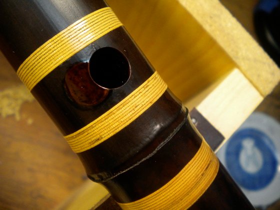

Hi Marek, I have played some flutes where I know my hand will never conform to the spacing. Also, many professional players have the holes moved. Have you considered asking the maker about this?
... I also believe that offset holes help in the beginning perhaps but hurt in the long run because they force your hands into unnatural positions.
I was recently asked to move the #1 hole on a 2.4 that was offset. The owner said the same thing, the bottom hand was forced at an angle. This was not noticeable at first, but during serious practice he began to notice the strain. It is now in-line and definitely feels better for me Smile

Question for Perry, Ken or anyone who knows: How do you feel about moving holes laterally as far as how it affects the way the flute plays? I have a Morohoshi 2.1 that was Masa Yoshizawa's main 2.1 It's as good an instrument as I can imagine and I'm sure I'll own it for life as a working instrument but the bottom hole (ro) is located way too far to the right for me to play comfortably. The idea of drilling and plugging the holes and the resulting look seem an obscenity to me but for it to be my performing axe it has to be done. When under pressure, jettison cosmetics. But will this negatively impact the playing quality?
Hi Jim,
Holes should not be offset on flutes as short as 2.1. A lot of great flutes have holes moved. It's not ideal but it's also not a crucial problem. Especially if you are going to be using it yourself for the rest of your life. Lefties frequently move holes, and righties who buy lefty flutes move them as well. It's a normal practice. I have several flutes of Ken's which were originally 3.0 and then he changed it to 2.3 all holes have been moved.
Jim Thompson
Thanks Brian.
This flute was built for Masa personally. He had very small hands and liked the bottom hole way too far to the right for me. It's good to know I can have the hole moved without losing any tonal quality.
If the new hole has the right architecture it will sound good. I had a 2.7 which originally had inline holes. But by the time I bought it there were two offset holes. I asked Perry to plug those and expose the original holes. It sounded much better after that........but that's because the original holes were shaped better.
