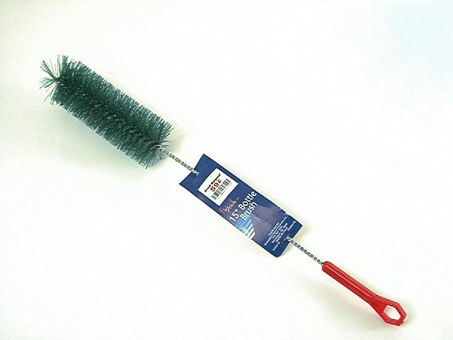

If I do see mold and I want to clean it, what is "bottle cleaner"?

A bottle cleaner looks like this and is meant to be used for cleaning bottles. You can buy them in supermarkets.

Also dryer vent brushes work great. You can get them at any hardware store cheap.
