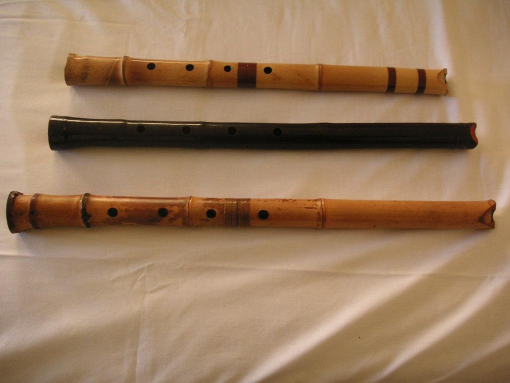

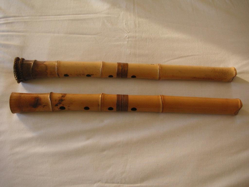

Here's my Miura Kindo with cherry wood bindings by Kiyoshi Kudo. It's second from left.
Perry Yung did something similar for me on the nakasuge of a 1.6 Momose Hodo which needed bindings replaced. I forget what wood it is. It's the one on top.

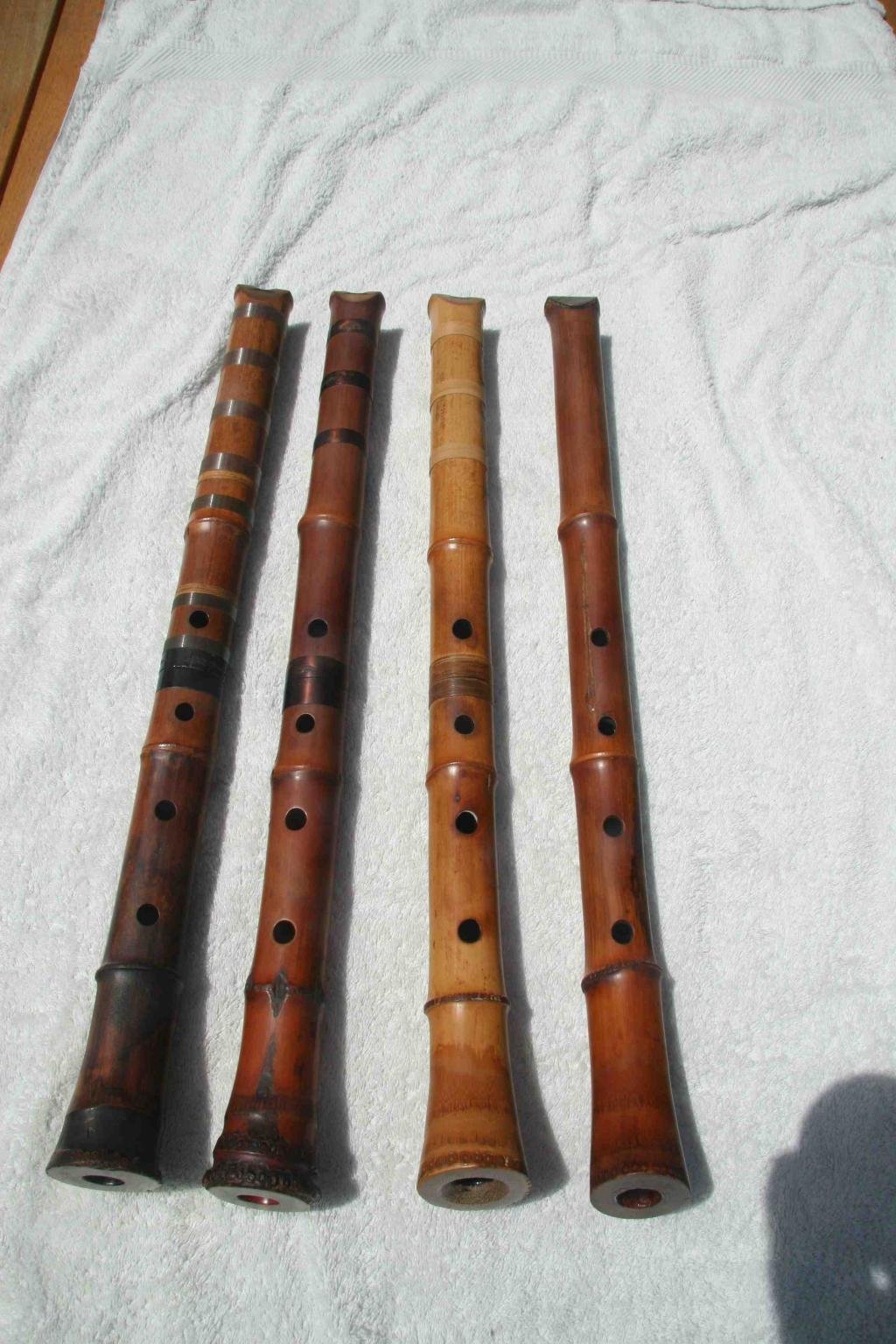

Here's a good example of nylon bindings painted over with urushi because the flute was cracked to smithereens and really needed some help. This is a very practical method. The flute is a 2.3 Taimu called Frankenschwantz.
url=https://img71.xooimage.com/files/1/7/3/frankenschwantz-2ae0dbf.jpg]
[/url]
If you look at the 1.7 at the top of this pic you can see a very refined version of nylon covered with urushi. This is very nice but it can chip. Still, much more stable than rattan.
As far as I'm concerned these are all better solutions than rattan. Rattan is an example of tradition being followed past its used-by date.

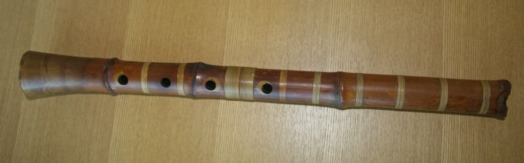

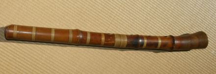

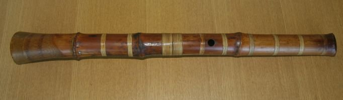

Here are a couple of photos of my Kyomudo 1.8 that burst open in many places 21 years ago. The repair was done by Kyomudo sensei at that time with inlaid rattan and it hasn't budged in all that time.
The thing that I like about inlaid binding is that the inlay protects the outside edges of the rattan from wear, and depending on where the binding is, it doesn't create a grip irregularity.

Inlaid bindings are nice........people say it changes the sound but I don't agree. People have to also consider the price of the various repairs. In the case of a serious flute like my Kindo I did not spare any expense. And the cherry was over inlaid bindings. For many of the more inexpensive instruments inlaid rattan bindings like yours would be more expensive than the flutes themselves if you got it done in Japan or even from the Western guys. It also depends whether the instrument needs bindings as a repair measure as in your case or if it it precautionary. I always spend less on precautionary bindings than on the ones for cracked flutes, because some flutes never crack.
