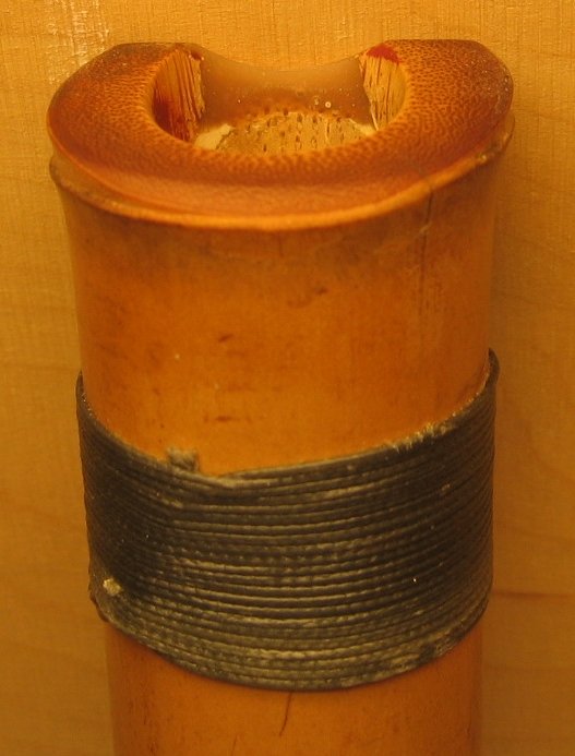

There is a binding near the blowing edge. Looks ugly. No visible cracks. Maybe its bound for aesthetic reasons. Can i remove it without damaging the flute?

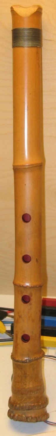

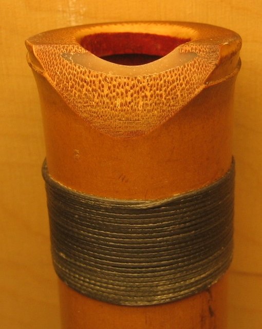

Didn't know that. Here are some pics. Can provide more if more details are required.
Here you can see that the inside lacquer is partly gone. Should the bore be relacquered?
Looks like the utaguchi may have been replaced, which is why it's a Tozan rather than Myoan utaguchi. Looks like a Myoan flute. Don't expect this flute to miraculously turn into a state of the art instrument attuned to Western pitch. Use it for primitive playing. Might have a nice tone, can't tell from a picture!
Hi Low Blow, the utaguchi is a filled resin. Probably epoxy of some sort. That shouldn't be an issue, though I would probably take the utaguchi face down a bit more(that means to uniformly remove a small amount of face material with either a fine flat file or fine sand paper on a flat block) until the top edge of the insert portion is relatively continuous and at the same level on both sides (the small lip on the upper right edge needs to be taken down.) I would also make sure that the bore side of the insert portion is smooth without any big gaps or ledges. These will definitely disturb the airflow.
It seems that the binding was put on the prevent further spread of the crack on the back right of the blowing end. As Perry says, it's certainly okay to remove the binding, but I would also suggest that you consider doing something more to prevent that crack from spreading. Maybe more aesthetically pleasing binding or a staple or pin.
Good luck with it.
Good luck with it.
