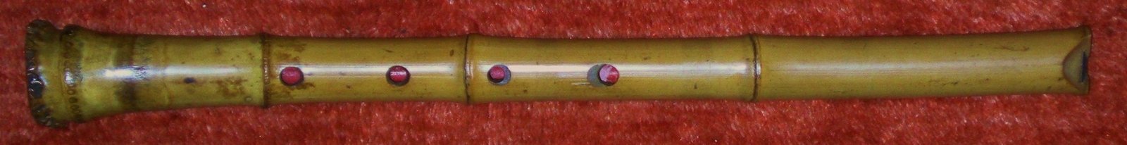

Hi,
its a root end. See picture.

that looks like a nice flute with good nodal placement, well i can tell you to go look up on Ken's site http://shakuhachiforum.com/viewtopic.php?id=2452
