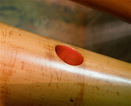

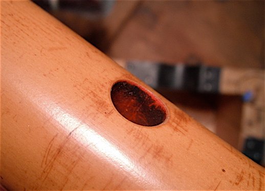

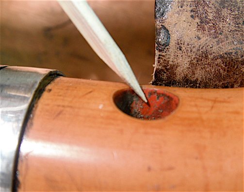

Hi All, I was refurbishing this old flute.
The finger holes were caked with years of grim.
I had to loosen it up with a Shish Kabob skewer.
The thing I love about Urushi is that it polishes nicely. I think the flute sounds a little "cleaner" now :)
