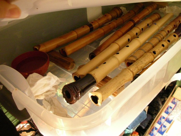

yea i was thinking about the mold issue. was thinking about gluing some type of plastic foam to the inside of a plastic box and use it. and so far i didnt find a big enoughplastic humid box for a nobekan shakuhachi, so im thinking about making myself a new humid box from a wood covered with Formica on the inside to reduce mold into minimum.
how do you prevent mold in ur humid box with long urushi curing? like the bore red? replace the wet rags every 3 days? how do u prevent the mold from getting the bamboo?
Hi Itmar, sorry for the late response.
My urushi teacher once placed a freshly painted bowl in a clear kitchen trash bag and blew it up. The breath provided enough humidity to kick over the lacquer by the next day. Moisture beads build up throughout the interior walls of any closed plastic container. The entire container is humid, it doesn't just rise from the bottom.
I use a plastic bin because mold is a major problem with untreated wood or bamboo. I don't want that getting onto the bamboo
I found my flat plastic bin at Target. It fits a 3.0 at an angle. Kinya's humidbox in Japan is made from styrofoam, custom sized for Chokan. I think you can make your own (even a cup of water in a cardboard shoe box can work for many small jobs. Then you can recycle the box when you see mold.)
If you see mold on bamboo, I found that a mixture of Tea Tee oil and water is effective in removing it. But, there are different kinds of mold so my solution may not work for a particular mold in your part of the world (also, mold stays in the pores). Grape seed extract and vinegar are other natural solutions that can be effective in removing mold.
You have to remember that working with bamboo, especially combined with urushi, is like playing the flute. There are many approaches and philosophies. One has to experiment to find what works. I try my best to impart my own experiences here on the forum but empirical knowledge is best. Keep working, keep experimenting and take good notes.
Hope this helps. Let me know what you discover - Perry
. I found my flat plastic bin at Target. It fits a 3.0 at an angle. Kinya's humidbox in Japan is made from styrofoam, custom sized for Chokan. I think you can make your own (even a cup of water in a cardboard shoe box can work for many small jobs. Then you can recycle the box when you see mold.)
"Itamar Foguel""Itamar Foguel"thanks Perry!
