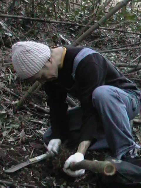

Here's a shot of my last harvesting in Japan. You can see the dead (goma), fallen pieces of bamboo in the background. This is a common sight in old groves. Most are not usable due to the insect damage. The bugs eat through the walls but you can't see this right away. It takes some experience to discern the difference from the usable goma pieces.
