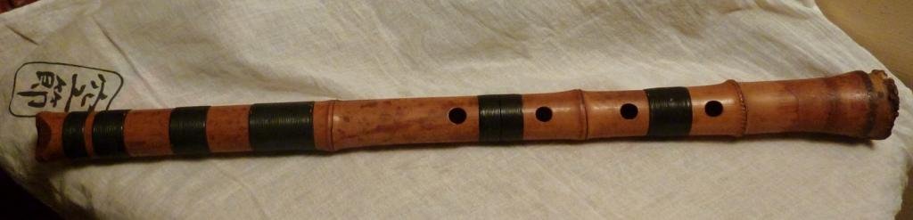

What I meant is that the two parts are moving a bit when I hold the Shakuhachi, although it seems properly assembled.
I followed your advice, and I pushed to the maximum the upper part from the lower part of the Shakuhachi, and it is better! Thank you.
Can we put something (a cream or other product) so the two parts hold better together, if this is necessary. Is it already happened to you?
I take advantage of it to present him to you:

"Plume Blanche""Plume Blanche"What I meant is that the two parts are moving a bit when I hold the Shakuhachi, although it seems properly assembled.
I followed your advice, and I pushed to the maximum the upper part from the lower part of the Shakuhachi, and it is better! Thank you.![]()
If the joint is moving while holding/playing the flute a wrapp of plumber tape (Teflon) might help. I did it at a loose joint and it worked quite well for nearly a year now. One round of the thin tape may do. Put the flute appart and wrap one round of plumbertabe around the nakatsuke and put it back together. Hope that helps. Everything
else (adding coating / laquer) must be done by an expert. Perry Young is your man here.
Yes, I pushed him against my belly, and that fits much better. But not of " clicks ". Maybe because it is an old boy (Ronnie Seldin said to me that he was almost hundred years old).
I am very happy and honored to have this Shakuhachi with me, even if my play does not deserve him. The fate put him on my road, also I think that he does not hold it against me!
He has a very soft and deep sound which I like particularly. And I think that we have a long path to be together made.
I thank you for your answers which helped well me.
