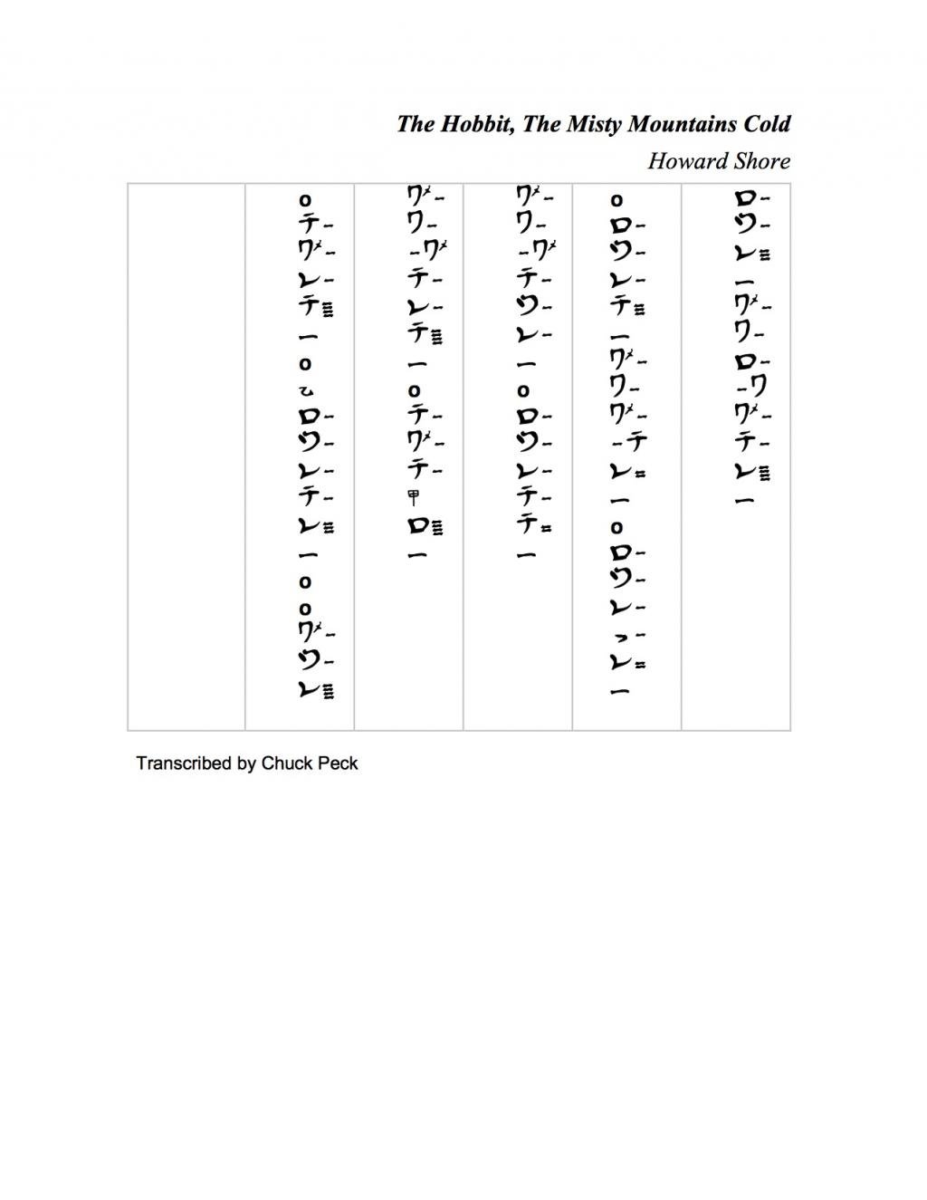

Hello All,
I transcribed the music for the song The Misty Mountain Cold into shakuhachi notation.
Please let me know is you see any improvements it could use.
Chuck Peck

Just played it. Works fine for me Wink

Thank you for the score ! Smile
Being a novice in Shakuhachi, I would like to have some precision:
- The small horizontal lines next to notes, mark the beat, that's right ?
- When there is a cross next to a note, it is that it is a # (for example a C #)?
- The horizontal lines under certain notes indicate that it is necessary to take its breath?
- I have no idea of the meaning of the "O"?
- When there is the symbol Kan, the notes which follow are all in this register, until we see the symbol Otsu?
Thank you. Wink

Plume Blanche
I found the answers to the questions that I had in the book that I have just received, but I have always the question of the "O".
Could anybody say to me what means the sign "O" in a score for Shakuhachi?
Thank you.

"Plume Blanche""Plume Blanche"
Thank you.
• En notation Kinko : un silence dont la longueur dépend des marques de pulsation (les petits traits omote et ura) ;
• En notation Tozan : un soupir (silence d'une noire).
Plume Blanche
Merci de ton aide !
