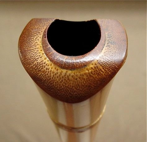

Since you have the flute already made, you may want to try inserting an Ikigaeshi - breath return. I do this on very large diameter bamboo flutes.
You can probably use any material - plastic, wood, bamboo, what ever is thin and can be glued to PVC. After it's glued in, just shape the back to to fit your son's chin area.

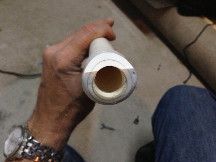

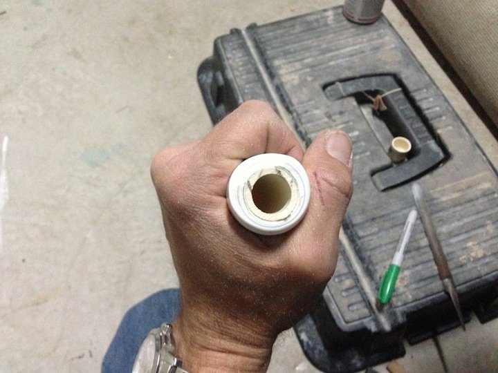

Thank you for all of the suggestions. I undertook this project, and kept track of the steps that I used to install the Ikigaeshi:
I ended up using a 1/2 to 3/4 CPVC reducer that fit into the 3/4 schedule 40.
I inserted this into the mouthpiece until it was firm in the opening, and marked this location. I cut this piece off and reinserted the section marking the Utaguchi
Once I had this marked, I removed the section that would have fallen under the utaguchi, and epoxied the piece into the opening using a food safe/aquarium safe epoxy that I purchased from a specialty aquarium store. Once this cured, I began shaping the insert and the chin rest.
I continued this until I had the profile and smooth transitions that I needed.

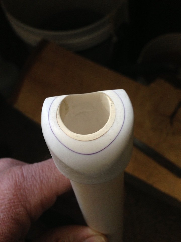

The finished Ikigaeshi...
My son will get to give it a try tonight, and we will let you know how it goes.
Success on the Ro sound tonight by my son! He was so excited after the other night. Now we just need to locate a teacher in Albuquerque...
